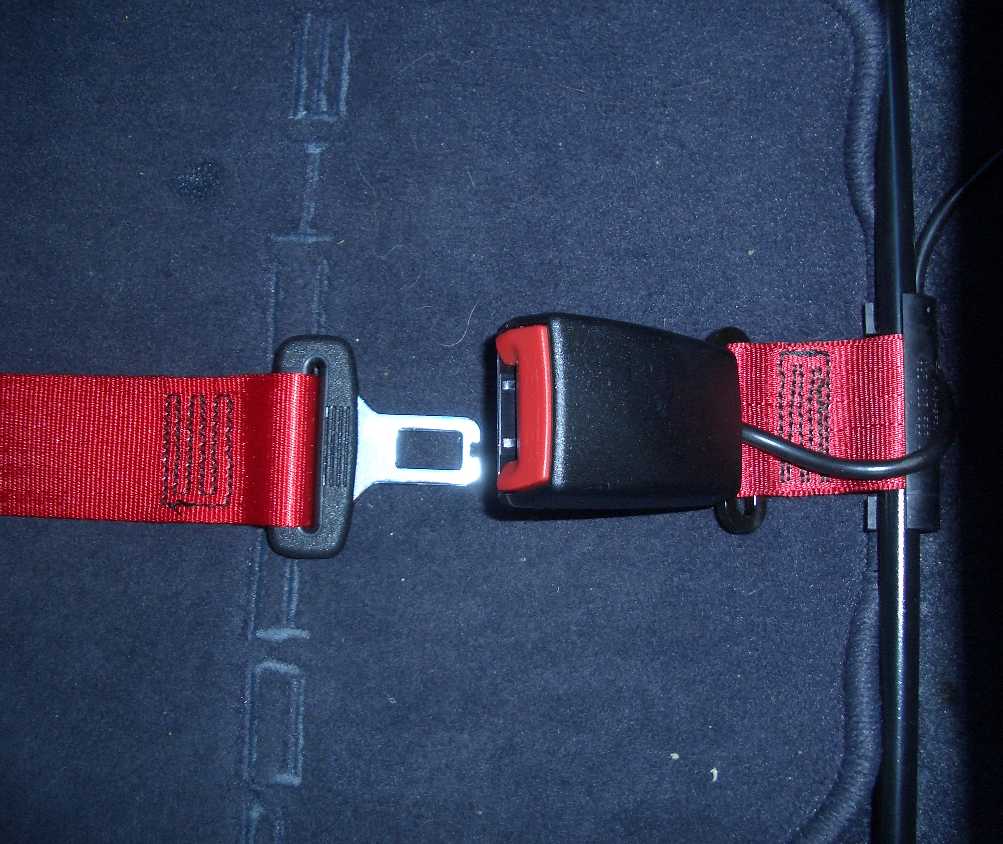

Could anyone tell me if the airbag de-activation kit (for use with a child seat) can be used with a non-Porsche child seat. The issue is that the Porsche branded child seat has an additional buckle which plugs into the airbag de-activation unit.
I believe that a BMW 3 series rear seat belt buckle (male part) will fit into the air bag de-activiation device, has anyone tried this and does it work? I was planning on using a Britax child seat in conjunction with the above BMW buckle. Any advice or other thoughts would be appreciated.

Thats the airbag deactivation kit fitted. Pretty straight forward (says the very clever Mr McCanna who did it!).
I now have a key that truns it off (actually just car key) which is located passenger side. There is an indicator to remind you that its off on the centre console, and a warning on the dash.
Two brace thingy's have been fitted very discretely to the seat so that the Baby Seat can be harnessed in. All I need now, is a baby........................
Had the airbag de-activation kit fitted at Jaz Engineering and the tracking done at the same time. Steve is a very helpful chap.
Was able to get a "tounge" to fit the airbag deactivation device from Quickfit SBS Ltd in Stanmore (www.quickfitsbs.com) again very helpful people. This allows me to use a non-Porsche child seat.
