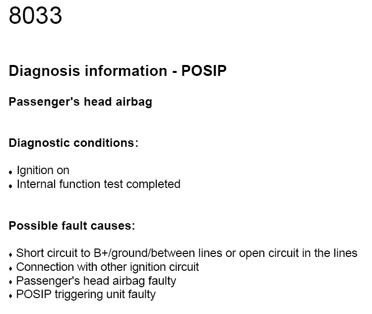

It all seems a bit strange to me that you removed the door airbag connection, but the fault relates to the head airbag. Here is the diagnostic info for 8033, but apart from checking connections, it isn't much help.

According to what I read on the Porsche website about posip they call the airbag in the boxster door the head air bag in the gen 1 987 - the airbag I am referring to is the one that runs along the top edge of the inner section of the door and is u shaped.
There is only that airbag in the door, there is one in the side of the seat bolster and another in the dash but that is it on my car.

Sorry - you are right about the head airbag being in the door. Porsche describe it as "For the new Boxster a separate head airbag has been developed which functions in a similar manner to a curtain airbag, but which inflates up from the door window channel in the door-trim panel, rather than dropping down from the roof." I hadn't realised that, and assumed they meant the dash airbag, as I haven't heard of the door airbags referred to as head airbags before.
