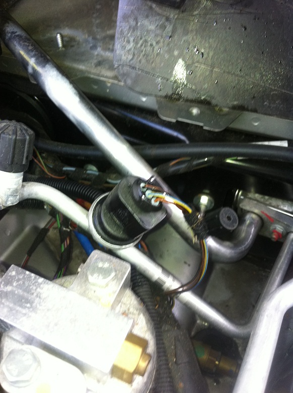

Just went out to take a quick look on mine and it looks easy enough, any air con place or OPC should be able to do it quickly and regas presuming they have a replacement plug. Does he have a warranty?
My nephews Cayman has leaked all it's aircon gas tonight through the top of the black plastic plug in the attached digi!
Anyone know if this is a major or minor fault to fix

That looks like the pressure sensor, part number (But check with VIN): 955 613 137 02 price 35.17 plus VAT. The O ring should also be replaced, part number 999 707 555 41 price 1.22 plus VAT.
Many thanks you are not only a technical wizard but walking price list too [;)] Nephew is on the case to get it sorted now he is armed with the info
