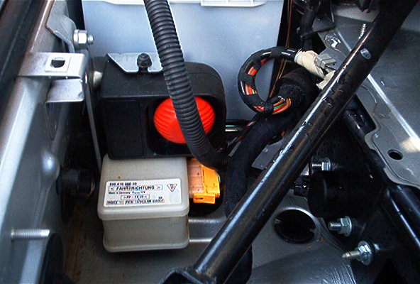

I can't remember what year your car is, but if it is pre-2001ish, check that the alarm tilt sensor isn't filled with water, which is a common source of false alarms. It is located under the cover to the right of the battery as you look at it. (The box with the white sticker in the pic).

You really need to know exactly what is setting it off, so getting it plugged in to a Porsche tester is the best way of diagnosing the problem. That said, the two common causes of random false alarms are the interior monitoring sensor (near the rear view mirror) and the tilt sensor (on a '98 car, to the right of the battery as you look at it). Take a look at the tilt sensor and see if it is full of water. You can see the tilt sensor under the black/red alarm siren. Disconnecting it (remembering to switch on the ignition before you do so) might eliminate it as the source of the problem.
