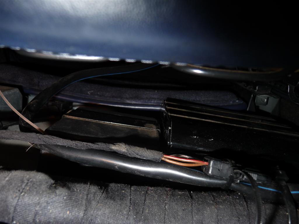

On ours we have the following setup..
Siren in the Engine Bay.
Brain in a black box under the Drivers Seat (not Passenger as previous stated)
Sunroof closure module passenger footwell (behind wheelarch carpet)
Central locking and sensor modules Drivers footwell (behind wheelarch carpet)?
Hope this gives you some ideas of where to look..
adam.

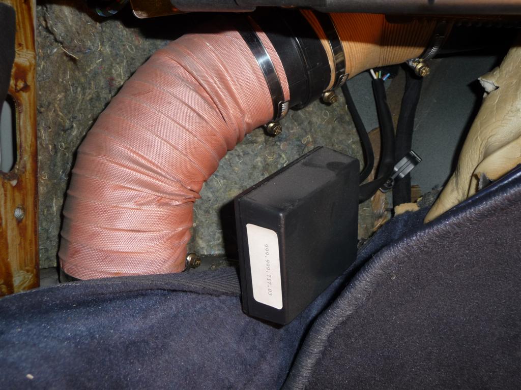

What does this module look like? - I have a grey plastic box (about size of a fag packet) behind the passenger wheel arch carpet. Always wondered what this is.

Each of the modules are little grey boxes slightly larger than a fag packet, jamed around the heater regulartor motors, in the footwells, the reaosn I know is I have just had to replace both these motors, along with the recirculation motor not so long ago..

Sorry to mislead everyone.. but got confused between my 3.2 and 993..
Alarm Brain is under the DRIVERS seat in a tamper proof (resistant [8|]) metal box, and not along side the ECU..
To the side of the Brain is a small grey box, which I beleive is teh module for the Ultra Sonics.
Modules in the footwells control things like, Central Locking, Windows, Sunroof, Cab Hood etc..
Not 100% sure if they can do more than one thing per module.. don't think so..?
