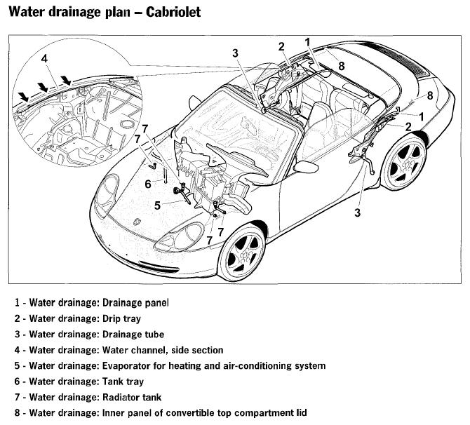

The rear drains are at the side of the cabriolet storage area, and run into the rear wheel arch. Hopefully the diagram will help.

Looks like I may be having a similar problem with my '00 C2 Cab.
Recent Scottish summer weather (thunder and lightning and some flash flooding for good measure) and I seem to have a very wet rear passenger footwell. I'm in the process of drying it out and thought I would test the drainage holes per this post.
There are three drainage holes (item '4' in the picture) per side and it looks like all three drain forward to the drain tube (item 3) in front of the rear wheel. When I poured some water down the two rear most holes, the water dripped from behind the rear wheel whereas when I poured water down the front most hole, it poured out from in front of the rear wheel (where I would expect it). Does anyone know if this is how it is supposed to work? Have I misinterpreted the drawing?
If this isn't how it is supposed to work, will the routing of the water for the rear most holes cause any problems?
