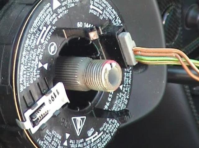

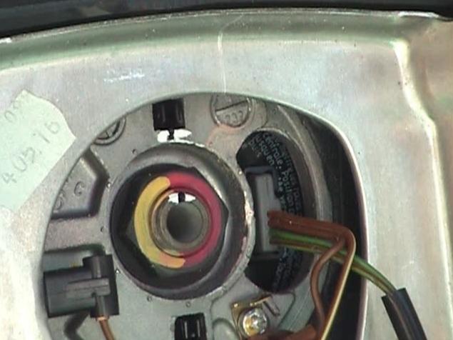

If you reposition the steering wheel you might be able to tell if it has ever been removed. There are paint marks on the nut and splined shaft, It is usually red paint, but in this picture there is also yellow paint.
Before you pull the wheel offf you should mark the position. In the picture you see 2 white marks I put on the wheel and the shaft. Then with a black marker I made match marks. When you put the wheel back on you usually match the 2 black marks - but in your case you with go to the left or right by one spline.
There are 2 black plastic forked prongs that go into square holes in the wheel. When you start to put the wheel back on you want to make sure those prongs are going back into the square holes.

The air bag is held in place with two T30 torx screws on the back of the wheel. The air bag is heavy. When you unscrew the screws hold the bag in place with your hand so it does not fall out of the wheel. There is a yellow plastic connector on the back of the bag. This connector just pulls off. Place the air bag with the cover facing up in a safe place so a lightning bolt can'r hit it and set it off....
Once the bag is out you can remove the nut for the steering wheel. There is a washer under the nut. Need a 24 mm socket. Then you can pull the wheel off.
