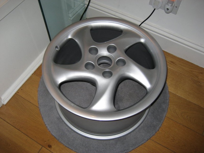

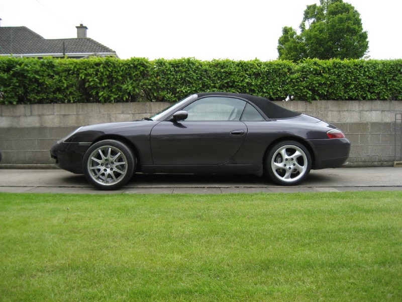

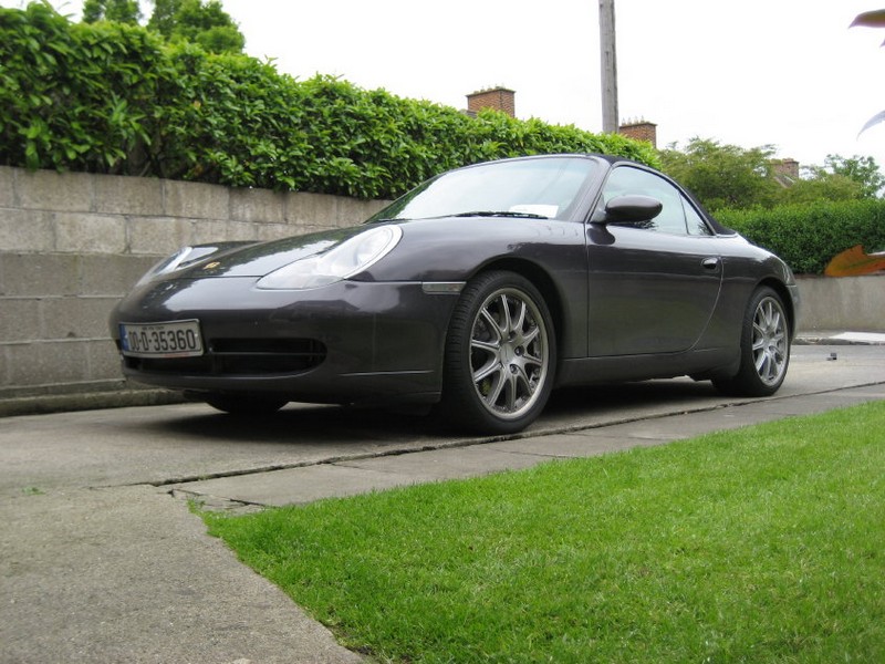

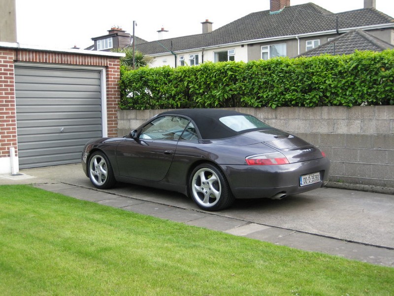

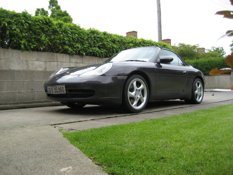

I just bough a set of refurbished 18" turbo tech wheels from Jasmine, to replace my GT3 alloys, which by chance are perfect!, I just always liked the 5 spoke turbos!
I had major concerns with the quality and Brian in Jasmine was very chilled and relaxed about his quality, however it was no refund if not happy and as I am in Ireland I had to buy first ship then see them, he kindly took some digital shots and emailed them in high quality. Told me 5 OPC's buy refurbished wheels off him, and that after 9 years doing it they have it as sorted as it can be. Still I worried cause I couldn't see them first. Finally bit the bullet as I was changing to Michelin Pilot Sports, bought 4 wheels, and 7mm spacers, and new nuts thrown in by Brian, they arrived to me in Ireland packed in individual boxed in bubble wrap, and now bare in mind people have said I am an anal fussy fecker!, I found them to be grade A the silver paint matches my centre caps perfectly, a big issue before hand, and the rims and paint, and top coat all where flawless. I was very happy with Brian and the wheels. They totally give the car uplift to.
I will change the rear spacers to 15mm soon as I love the subtle new way the rims match the wheel arches, but the back ones could go a little wider yet still not look butch.
I also bought 285 tyres with rim protectors for the back as opposed to stock 265, these look much better. No issues with the arches.
I had the wheels balance 3 times afterwards, final balance from OPC on OPC approved balancing machine removed all shimmy's (had one between 100 -105 mph, on the track your honour!)
