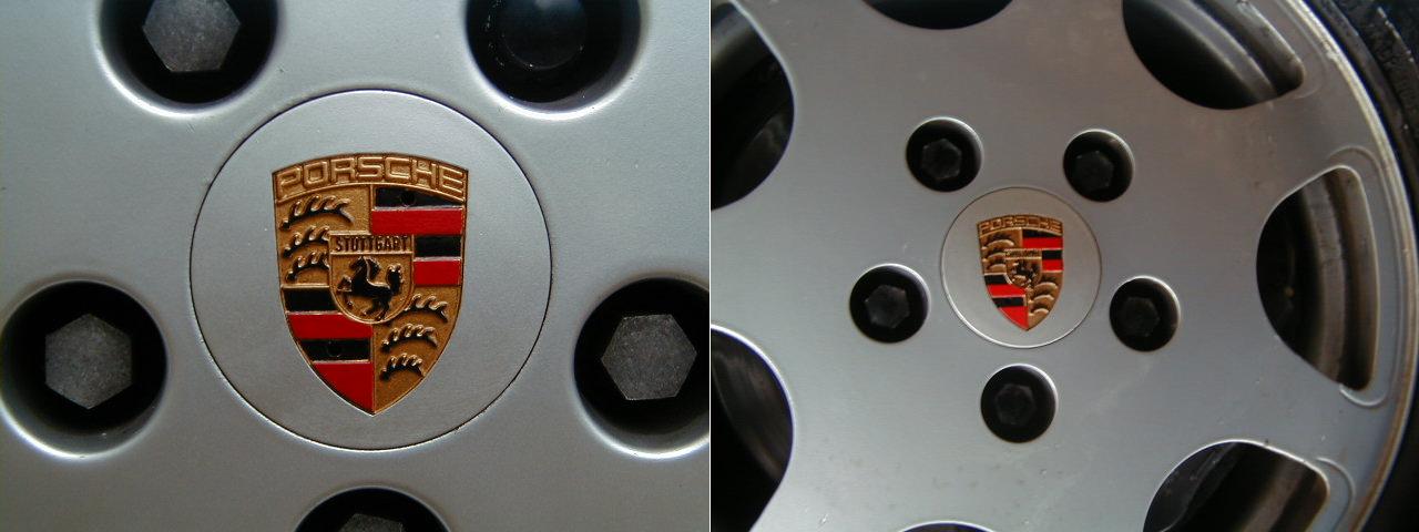

The paint on my Design 90 alloys chip off around the half moon sections and drop off probably from old age etc. So i bought some Humbroll Enamel number 11 ( from hobbie toy shop). Which is a perfect colour match to the Design 90 alloy colour. After two coats, the Enamel blended in perfectly and you couldn't notice any difference between the two colours and certanly not that it's been touched up. I was really chuffed at this cheap repair (£1.50). I also painted those horrible wheel bolts that always look old and tatty. The good thing about using Enamel is that it's very hard and doesn't scratch off and it doesn't show any brush marks.
