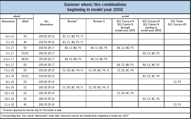

I just purchased a 2001 Carrera 4 Coupe with standard five spoke 17 inch Carrera 4 wheels. I really don't like the wheels and far prefer the more common 18 inch "Turbo Look l" wheel. Any issues I need to consider? Will the speedo need re-calibrating? Do I need spacers? How do I make sure I get genuine Porsche parts? I wasn't going to buy new so was looking on Ebay, there is quite a selection.

I'm currently in the same position. I have a 2000 C2 and am looking for new wheels - currently leaning towards turbo II alloys. Do the original ones fit a narrow bodied car, i.e. the 11 wide rears? Or do i need to get tubo look alloys (replicas)?

Be careful with ebay. A lot of sellers deliberately mis-describe the wheels when they are from Boxsters and not 911s. Check the width of the fronts they are the first give-away. Couldn't agree more with HH2002 - I would not fancy loosing a wheel at any speed!

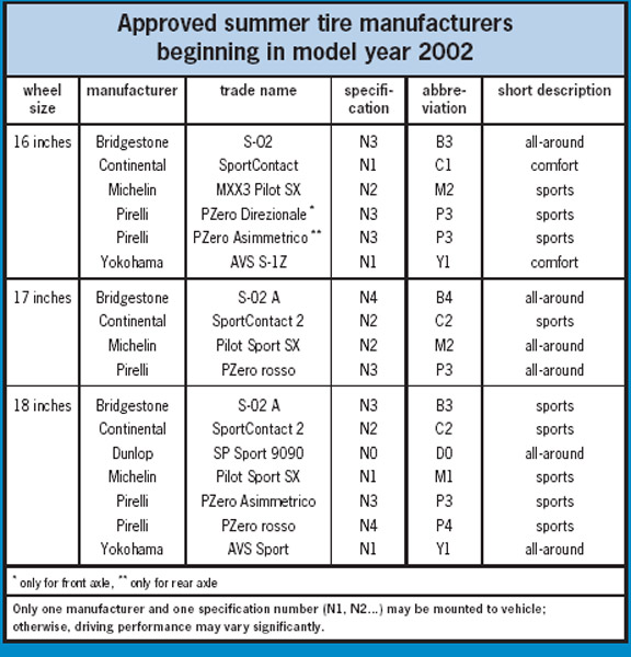

This should help..
Thanks for the info Black80XSA - looks like the 18 x 11'' will not fit on a C2!! or they're not recommended anyway.
Thanks everyone for all the excellent advice, especially Black80XSA. Its exactly what I need to ensure I get the right wheels.
