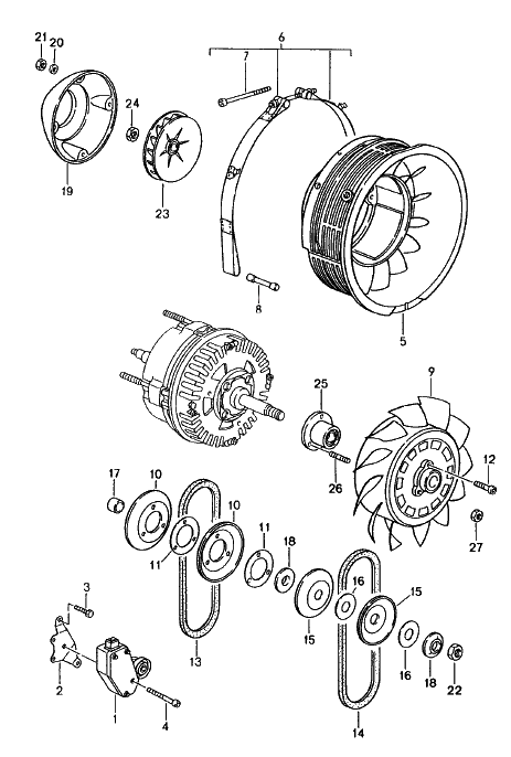

Looking at the parts listing by porsche, the alternator pulleys are items 15 (and are the smaller ones) and the fan pulleys are items 10.
(Alternator pulleys and belt are the ones which are rearmost on the car, the fan pulleys are between the alternator pulleys and the fan itself)

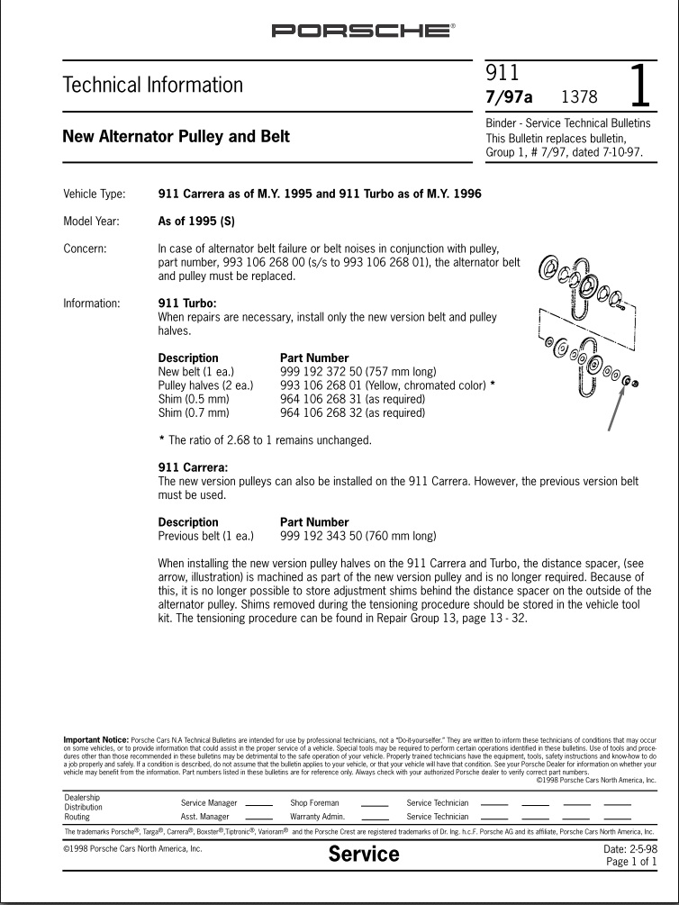

For anyone interested, now I have the hang of posting pictures, here's the pulley related bulletin.
Thanks for that Talby - the bulletin confirms my thinking that the alternator belt should be part number 999 142 343 50, ie 760 mm long, regardless of which pulley is fitted. As the belt I fitted was the same size as the fan belt at 776mm (as indicated on all the on-line shops) I think I'll try fitting the shorter one first and see if that sorts the squeal before going down the turbo pulley route.
