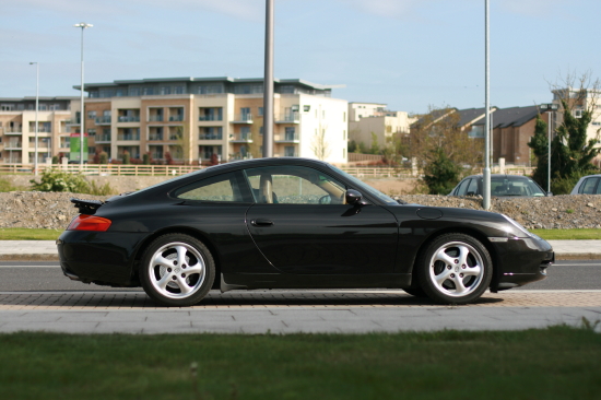

Hi Chris.
Sorry to hear about your brother. I'm a Gregory John rather than a Gregory Charles though!
As requested here's a pic of my 996.
