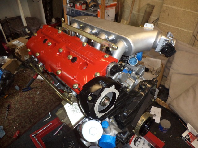

Finished building this today bar a few minor issues. Once 'Tim' had shown what to do about the manifold I thought I would give it a go and am very pleased with the result so far. Been running a thread on the 'other' site but thought some people here would be intrested in a photo.
Another 16v turbo project
- Thread starter sgl1966
Thanks, its had steel liners put in with ppm conrods and I had the JE 8 valve turbo pistons fly cut for the 16 valve head. Using a K27/8 which has been rebuilt. Already using Tom Barkers ECU in the 8 valve 3 litre turbo I have so should be a simple swap over as I am using turbo flywheel and clutch and associated ref and speed sensors.
