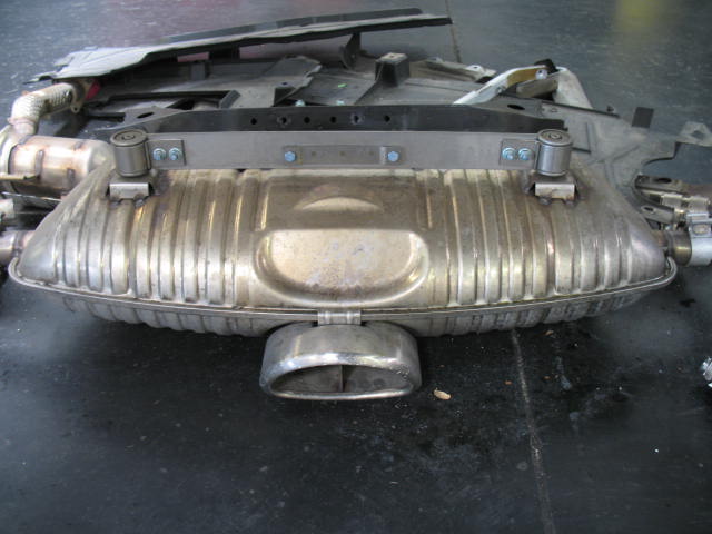

The ebay muffler is missing the blade that bolts to the 2 round things. You can use the blade from your existing muffler. Why are you looking for another muffler?
Here is a 2003 2.7 muffler with the bolt on tip. You can see the blade bolted to the 2 round things.
Thanks for the information... it seems the rear box I have purchased is unsuitable for my car if the one you have displayed in the picture is the correct item... it appears from the fittings that the exhaust i have is different... to this blade type.
