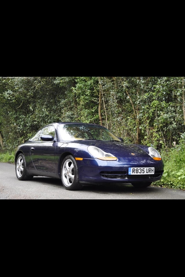

Well I have taken the dive and after 6 or 7 months if looking I have brought a 98 996 C2 in nice tidy original condition, even has the LSD option. It's still running amber lights and comes with full history from Porsche and then Jaz. It's got a few body mark scuffs, but inside and more importantly below its really good. The interior colour is not everyone's choice, but it goes well with the colour and I like it.
Only driven it a few times in the last month but its really starting to grow on me.
Few bits planned, but nothing too much at this stage as I want to keep it as original as I can.

Well done Ross. It looks like it might be a Savannah interior. I loved mine, which was also a '98 in Ocean Blue. I think it is a good combination, and much less boring than all the black interiors I have had since then.
Ditto on the interior - you can keep black and grey, I'm a tan man anyday! (possibly that came out wrong....)

Thanks for the comments. Yes it's savannah. Not too keen on the savannah steering wheel, but I like the rest including the headlining. The remote would not open the car, used the key and the alarm went off and couldn't be silenced with the fob, so flicked the ignition on and off and its been fine since. Have to say that is a very odd idea and the fact you cannot pull the boot or engine cover with a flat battery even stranger. I will take a few better pictures in time as that was a screen shot from the original sale advert. What tyres do people run? It's currently got p zero rossos on it which have good tread all round but are 8 years old. Used cont sport 3's on the 964 and they were always good. Thanks Ross
