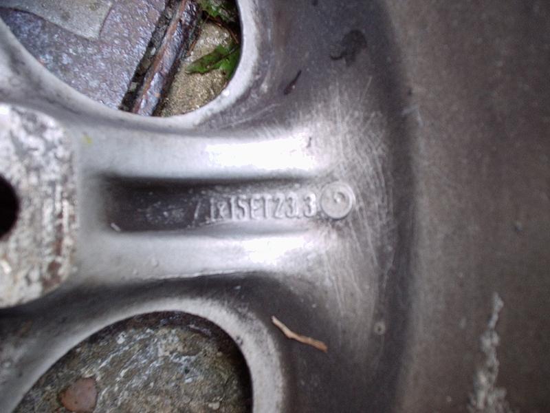

Well, to start with I'd think you've got 7x15's with 23.3 offset. Clean behind the 'spokes' of the wheel and you'll find one of them cast with the size/offset - see pic. This one is probably what your's will say 7Jx15ET23.3.
