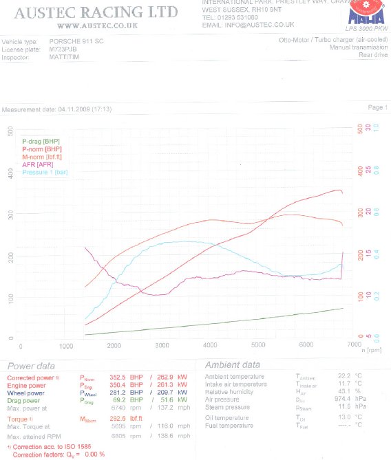

The downside of the kit is actually having someone good enough to tune the car as it has a piggy back UNI Q ECU. There are not many people who has the talent to do UNI Q tuning on an Air cooled 911. I eventually had my ECU re mapped to get the car set up right. The problem is heat generation on the rolling road. The really only way to tune the car is live on the road then do a single Dyno run to confirm gain. This has recently been completed and there is now lots of power through out the rev range.
Its a joy to drive.

The engine is completely standard. As the roots blower fitted is low pressure, 6psi at 4500 Rpm which drops to 4 psi (By design) at the red line the set up can be used on a standard compression engine. If i want to increase the boost then mods will have to be completed to reduce the compression ratio of the engine. I have a water cooled intercooler fitted to keep the intake temperatures down. Comparing to a Turbo which can run up to 1 bar, (14.7 Psi) this set up is very low pressure so can be used on a standard engine.
