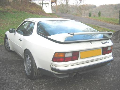

Here are a couple of pictures of mine with 15 mm spacers all round.
I doubt all four wheel arches could look any more properly filled.

You could have cropped your picture to remove the Alpine car in the background with the Cup1's ! [:eek:] [&o]

Here is '90 951 with 15 mm spacers at the rear on standard 9" D90s and the arch looks indeed pretty well filled as well. It looks better from the left than from the right - curiously the left rear wheel is more 'out' of the wheel arch than the right rear wheel. IIRC you chaps had talked about that in another thread, anyway.
