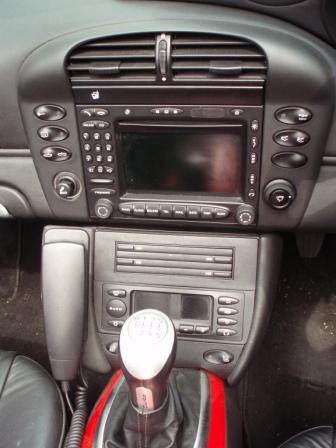

My 2004 996 has the PCM2, but with some sort of 80s Porsche telephone. Other than looking a bit naff (see photo) the phone stops the passenger seat moving forwards. I'd like to scrap it seeing as it's illegal anyway and convert to a handsfree bluetooth phone kit of some description.

Ooops! Forgot the photo...
I fitted a Nav-TV Tooki Bluetooth kit to my brother's Cayenne Turbo last week (PCM2.0). They are horrendously expensive new, but he got a second hand one on eBay for £150.
If you remove the handset you have to replace the side cover for the console. They cost a fortune in leather (£245+VAT), but the vinyl covered ones aren't too bad (£38).

Thanks Richard. I'll start looking out for a vinyl side cover. If I manage to find one and fit it, you're welcome to the old one.
