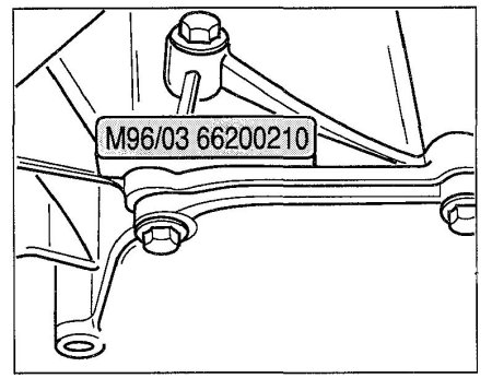

I suppost the only way to know for sure is to look at the number on the engine itself. Maybe 3.6L is an error on the log book. Does the engine number start with 661?
might sound like a daft question Richard, but where exactly on the engine is the number, ive searched the forum for this but cant seem to get a difinitive answer?
It is stamped on the crankcase. This is the picture from the workshop manual. Not brilliant, but it might help locate it. I'll be grovelling under my car on Thursday (exhaust), so I'll try and find it and take a picture.

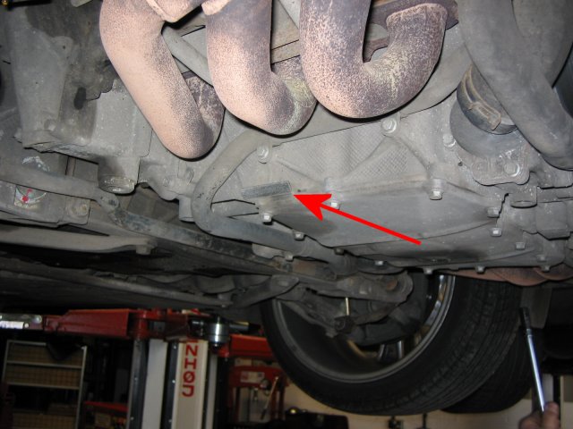

The engine no. is on the engine crankcase around the sump cover.

Here is the photo of the location of the engine number:
