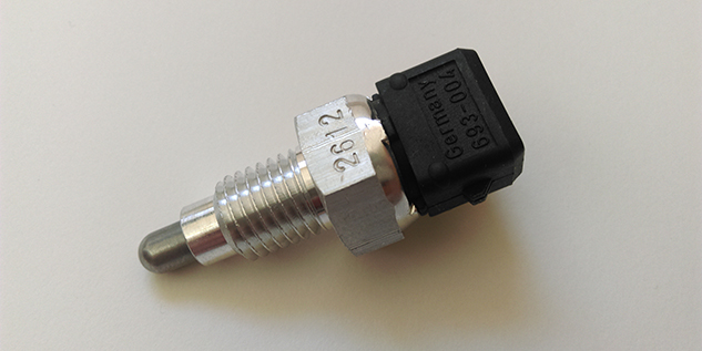

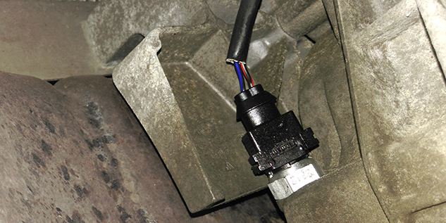

Having completed the job at the weekend, in practice it's very straight forward and can be done in less than an hour. However, before replacing the switch (part number 996.606.133.00 - £30.50 from Porsche Centres) I first tested it (by removing the connector and connecting a digital multimeter to the two pins in the switch) and established that it was permanently closed irrespective of whether it was in reverse or not. The most difficult thing is raising the car up sufficiently to give yourself some room to work underneath at the rear. I used the following tools to do the job: • A low trolley jack, wheel chocks, ramps and axle stands • A slotted screwdriver • Solvent (e.g. brake cleaner, white spirit, petrol, etc.) • Old toothbrush • A short 19 mm ring spanner • Threadlock (eg Loctite 270) • A 19mm deep socket • A torque wrench The process: 1. Raise car using suitable lift or jack 2. Support the car with stands under the jacking points and/or place appropriate ramps under the rear wheels 3. Remove the connecting plug (use the slotted screwdriver to depress the metal clip whilst pulling the plug upwards from the switch body) 4. Clean around the switch with the toothbrush before removing it to avoid debris dropping into the gearbox 5. Unscrew the old switch with the 19mm ring spanner 6. Put a ring of threadlock around the thread of the new switch about mid way 7. Place new switch in gearbox casing 8. Screw the switch in with fingers until it cannot be screwed in any further making sure the thread is not crossed 9. Tighten the switch to the specified tightness using the 19mm deep socket and torque wrench 10. Replace connecting plug making sure it is located and fully seated on the switch 11. Test for correct operation 12. Lower the car 13. Feel happy you’ve just saved yourself around £120
Pic 1. New switch (part number 996.606.133.00)
Pic 2. New switch installed in car
Notes: When I removed the switch it was accompanied by the sound of a slight escape of air from the gearbox. There was no washer or O ring around the old switch and no oil came out of the gearbox when the switch was removed.
Have fun. Alan
