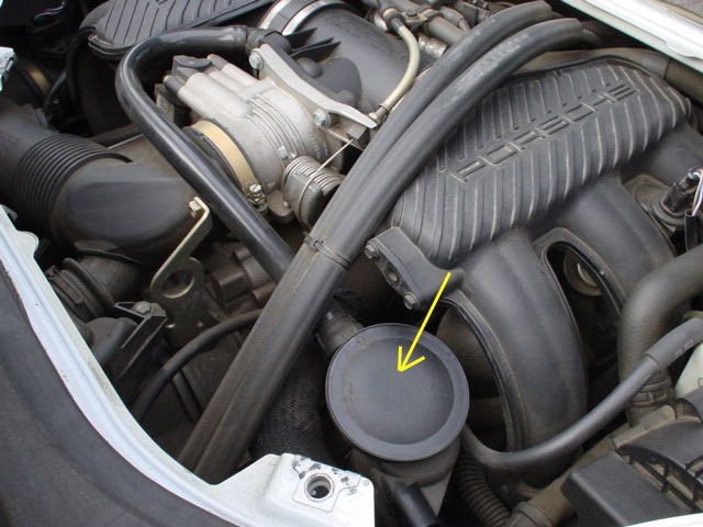

I have a first year 1997 and it was a horizontal design. I think 1999 was the first year for the vertical design. I am positive a 2000 has the vertical design.
It is a crankcase breather that separates air/oil and what is left is sucked into the intake and burned. Oil is returned to the crankcase. If it fails then oil gets sucked into the intake and you get clouds of smoke out of the exhaust.

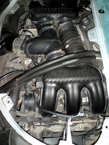

This is the horizontal version you do not have.

Air Oil Separator is part of the pollution control equipment and is intended to reduce the pressure in the crankcase in an acceptable way by allowing some vapour to be vented into the engine for disposal through the normal combustion process.
I have a 2000MY Manual 2.7 with the vertical design. I wonder if that's because it's a non-S or the difference between the UK & US market?
Or did I get one from the old parts bin?!
