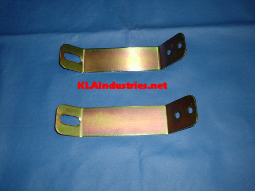

Forgive me for being a cheapskate, but how much did those cost, and are they really as simple as some zinc-yellow passivated bits of mild steel?
They triangulate the ARB mount back to another point on the car - what is the point that they bolt to? (When I last looked under mine I saw some threaded holes in front of the ARB mounts which looked ideal for the job of triangulating them, but those seem to be bolted to an aluminium casting of some kind, which slightly confuses me.)

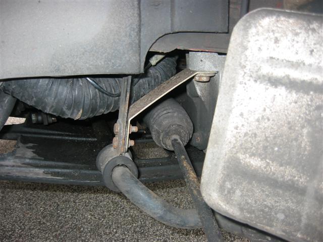

They are a bit of a pain to install actually. I don't know if you can see from the photo I posted but the brackets actually brace the drop links by bending them slightly forward. This makes them a PITA to fit as you have to bend the drop links forward to line up the bolt holes.
So - hang on (stupid question here) - do the brackets go in front of the ARB mounting points (i.e. towards the front of the car) or behind them? I presume from looking at the photo (and particularly the brake cooling scoops) that they are behind it?
The bolt holes I mentioned were in front of the ARB mounting points - I must be looking the wrong way (as usual, eh? Can't spot a pair of brake calipers, can't tell the difference between the front of the car and the back of the car - not my day, eh?)
ETA: How much difference do these mounting brackets make? The ARB mounting points are very spindly (particularly given the size of the ARB's themselves) but how much they flex will depend upon the direction in which force is being applied to them. Forces which are directly upwards or downwards will be resisted fairly well, I'd have thought.
Oli.
They mount behind the arb drop links and triangulates them with the aluminium cross member botl.
They make your drop links work. The drop links buckle under heavy cornering therefore reducing the effectiveness of your front ARB. These drop links prevent them from buckling and actually make your front ARB work properly. They don't make night and day difference but do give you a bit more control under heavy cornering. For £20-odd you are definately better off having them than not. Married to Powerflex bushes I think you'd really notice a big improvement.
