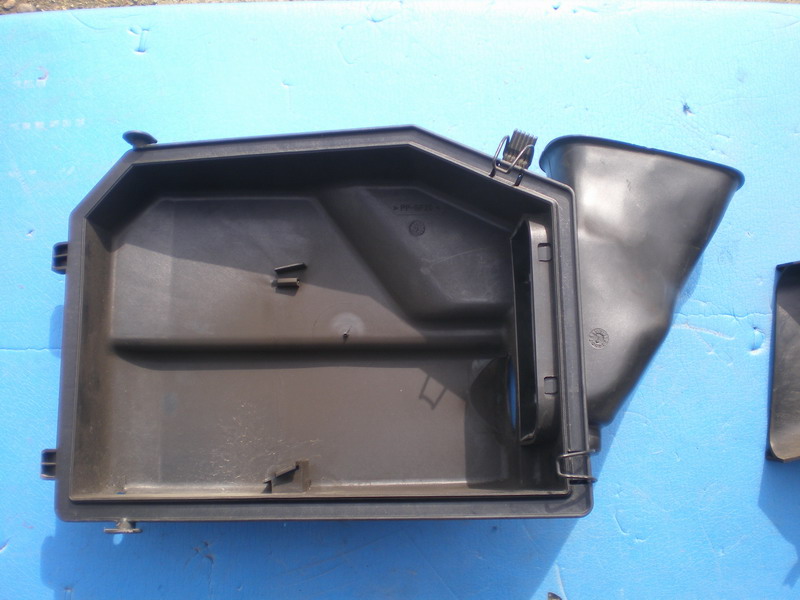

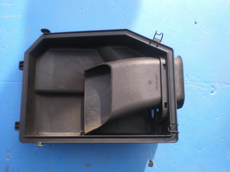

http://www.pelicanparts.com/catalog/shopcart/911L/POR_911L_FULint_pg1.htm#item1
Some tech info on induction kits for 993 rs.
Standard 993 intake
Turbo intake
