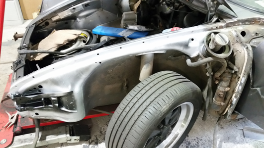

AutoUmbau - the guy is an artist. I have never seen cutting and welding like it. Repaired areas are finished by electroplating with zinc. Aircraft quality sealants and waxing to finish off
Image shows zinc-plating and invisible repair to my previously well-rotted car.
