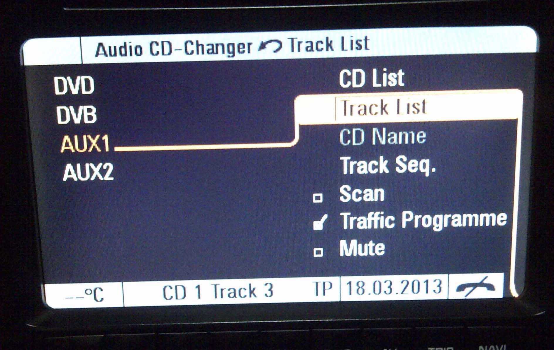

The 4 connectors are named, Aux1, Aux2, DVD and DVB.
They are selectable by using the track select menu or using the < or > buttons on the PCM unit.

I have attached a picture of the menu from the CD/CDC screen to show the menu for selecting the various input connector from the interface.
Sorry about the quality - these blackberry cameras aren't as good as proper cameras.
