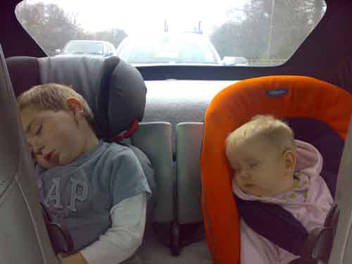

Here's a pic of my 2 monkeys sleeping soundly! The baby seat is a Klippan Siccuro, also recommended by Stanmore. The debate on 2nd hand seats and the Siccuro has been done before. They checked it for me and I have to say I couldn't be happier. Reclines nicely in the Cab and good leg-room, so no Jelly necking! Not sure about the orange but hey ho!
