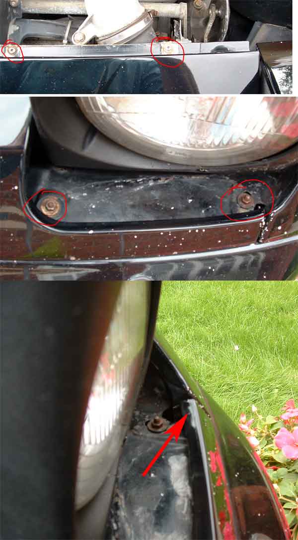

I took mine off yesterday to straighten the badge that some scumbag had tried to remove (see other thread). 4 screws along the top edge, 2 more nuts in front of each headlight (flip them up and you'll see them), and 2 bolts from the panel (under the lip - see arrow in photo) towards the wings and it slides straight off. It only took 10 minutes including straightening the badge [:D]
Decided to take a couple of pics to illustrate

Mine was a push fit (I prompted 924nutter in the first place when i was tackling the same job) and the only problem with not removing the panel is that you can't get enough 'push' to seat the badge firmly down so that it retains the gasket. The panel deflects too much before the badge will sit inside the lip of the gasket, and you may find over time the gasket starts to recede back behind the badge.
I've re-seated mine a couple of times (I was advised not to take out the screws mentioned earlier) but now it looks like I can safely do so I might just attempt that and get it to seat properly.
