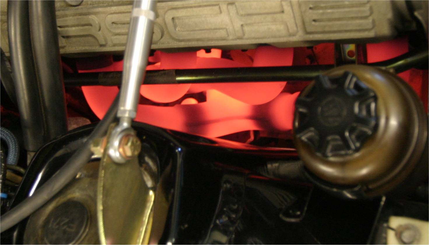

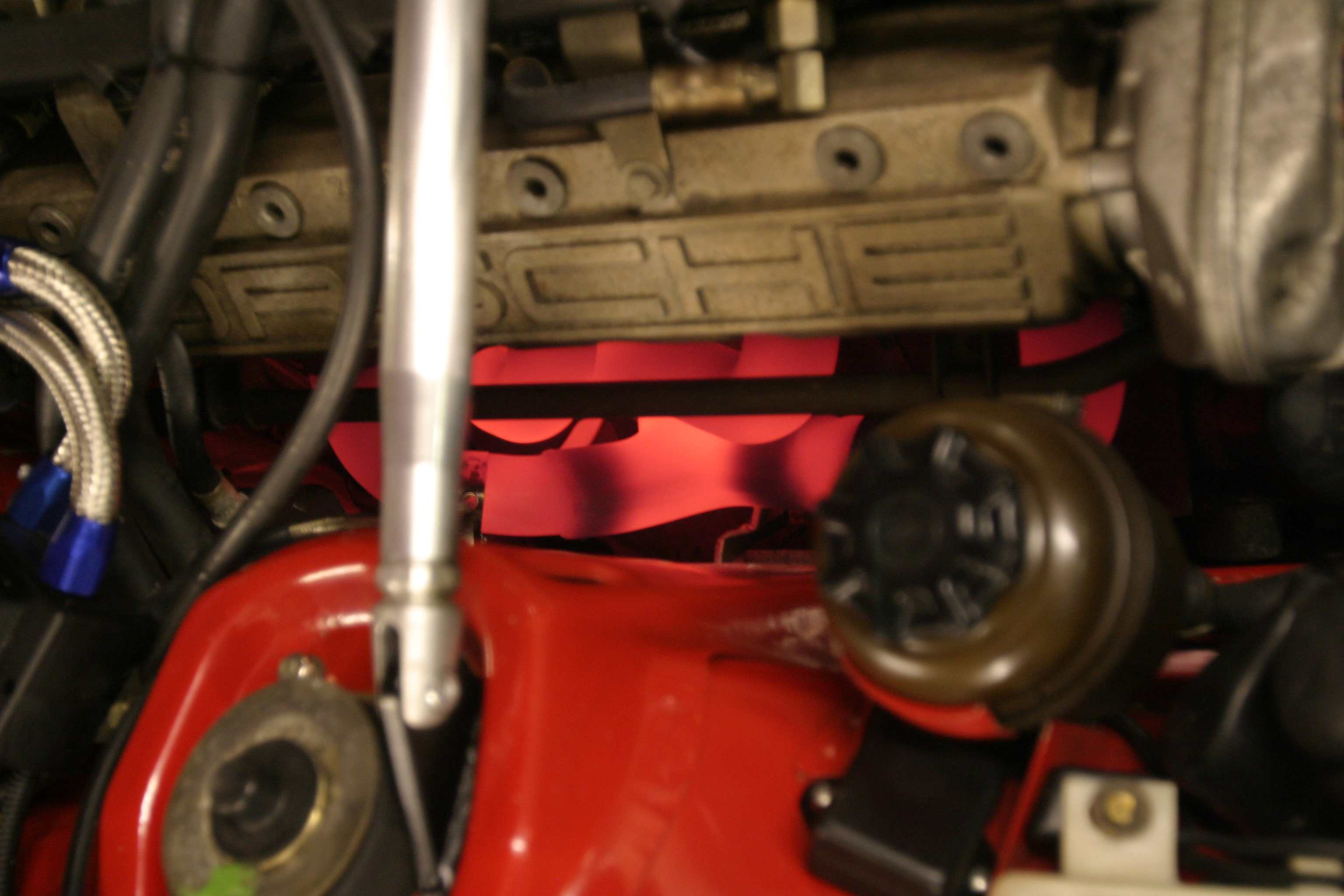

There are some cracking pictures of Beak's exhaust glowing red hot, if I can snatch copies from Rick or Graham.
like this ...
Mein Gott [:eek:]
That is truly awful to think that is about 2 foot from your feet when driving and immediately underneath the fuel pipes [:eek:]
I'm never using full boost again [;)]
