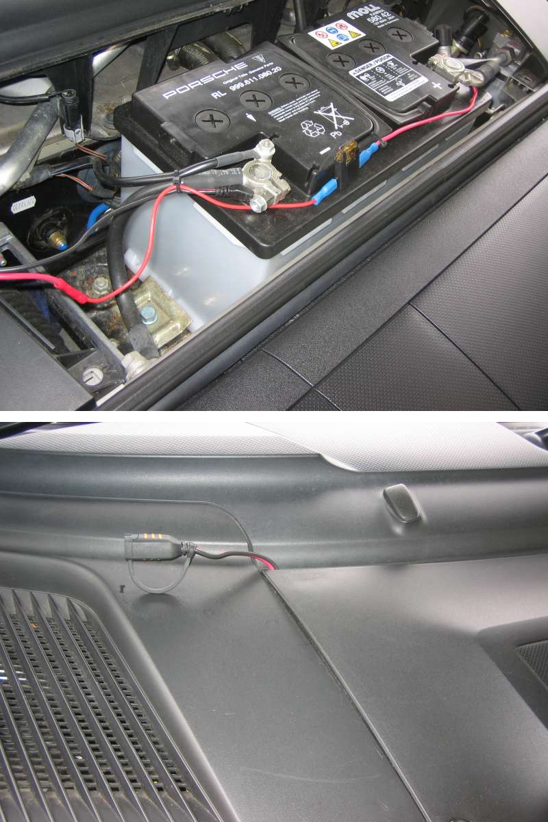

Here is what I meant about the permanent plug and socket connection to the battery. I used the Ctek connectors, and have the same arrangement on my 3.2, so I can use either charger on either car.
It is a 5A fuse. The charger puts out a maximum of about 3.5A, so I thought 5A should be enough, and it has been fine so far.
I got the connectors I needed by buying a Ctek 'comfort' extension lead. Nearly as expensive as the Lidl charger!
