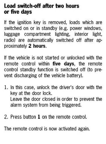

My cigar lighter is on permamently... just checked...
Most are on a "time-out" function - to prevent the battery running down when you park it with the tomtom/radar detector still plugged in and running, the power to the socket is shut off after an hour or so (not sure of the timing...)
So it's easy to think it's permanently live when it isn't [&:]
This is the load switch-off description from a 2003 manual. I'm not sure if the cigar lighter is affected. On mine, it definitely disconnects when you remove the key, so it's a handy supply for TomTom and phone. I believe that on most US cars the lighter socket is permanently connected.
