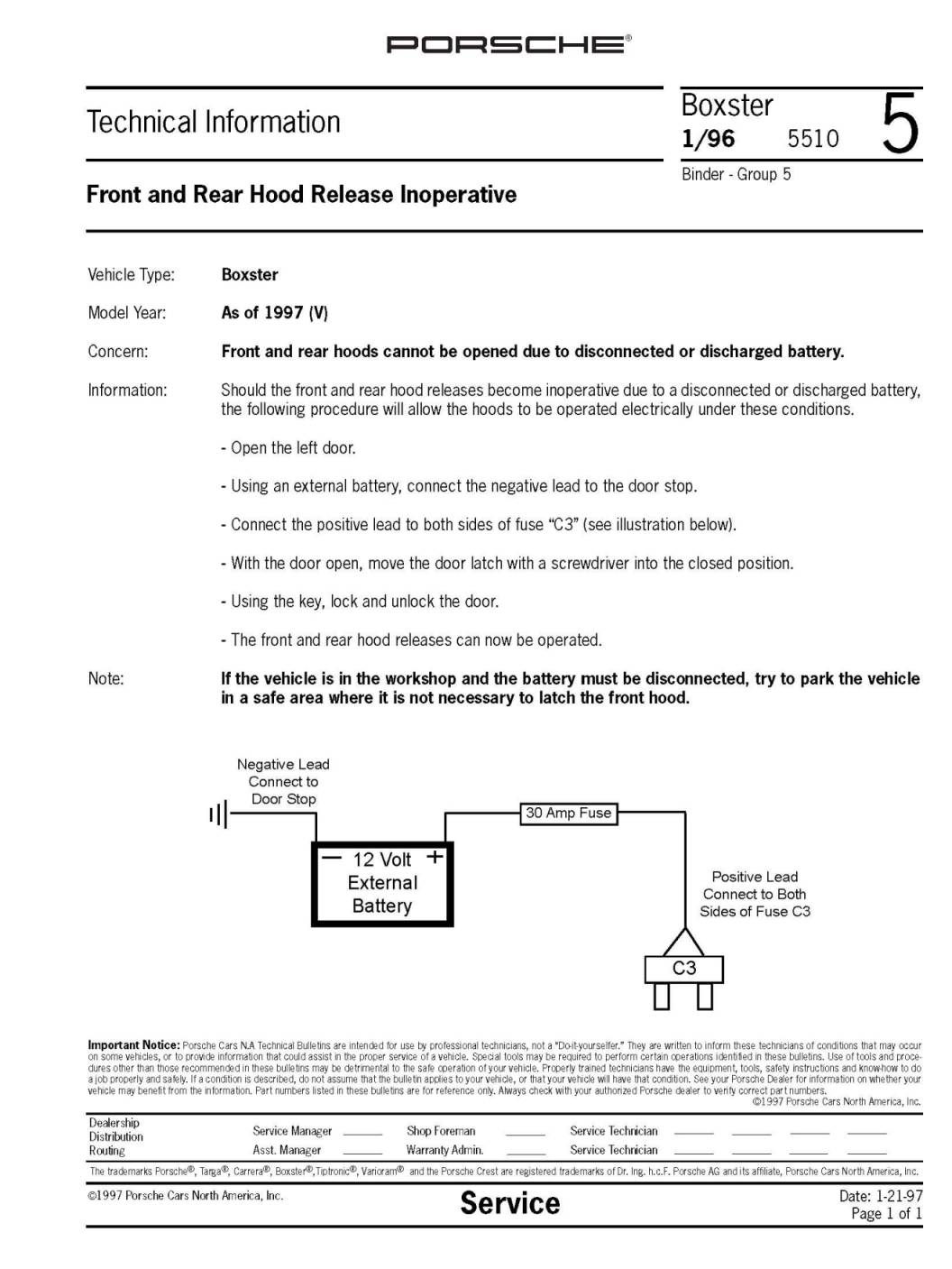

Seen a Porsche TSB electric fix for a Boxster, jury rigging an electric jumper through fuse C3 - anyone know if this should work for a 996 please?

Go for jumping fuse C3 first. It would save you a LOT of hassle. Works exactly the same on a 996 as 986.
