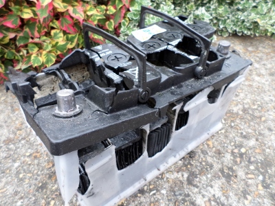

Hi Everyone,
Just thought that I would share my day with you!
Nice bright sunny day here in Cambridgeshire today so I thought that I would give my 996 4S a run and enjoy both the car and the weather.
Unlocked the garage, took the cover off, unlocked the car and removed the Porsche trickle charger from the cigarette lighter; all as my usual routine. Turned the ignition key to the first stop and checked that the oil level was normal. All OK, turned the key to the starter position and there was an almighty bang from under the bonnet followed by white smoke coming out of the top of the bonnet. At this point there was no power so I couldn't unlatch the bonnet to see what had happened.
Luckily I had a spare battery from my wife's A Class Mercedes knocking about so I connected it via the fuse box post and popped the bonnet.
To my horror when I opened the bonnet I found that the battery had exploded, literally exploded! The top of the battery had shattered and all four sides had been blown out. Luckily the battery box cover had prevented any damage to the bonnet, the cover had taken the full force and had shattered.
I have now removed the battery, washed the car down thoroughly and connected the Merc battery to see if the electrics still worked. To my delight everything fired up as it should.
Talk about ruin my day!
Has anyone else on here had anything similar happen to them? It was a genuine Porsche battery which I purchased as a replacement about 4 years ago.
I hope that you have had a better day than me!!!
Here are some of the horror photos!!!!!!
Looks as though this has been happening for some time Steve. Here's a report of a similar incident on a Boxster back in in 2010: http://www.porscheclubgbforum.com/tm.asp?m=574284&mpage=1&key=battery%2Cexplosion򌍺 As Brad has mentioned, it's worthwhile reading the article in the latest PP in the Boxster Register section. Glad it didn't cause any serious damage. A bit worrying though for us with an ageing (dreaded!) Moll battery. Jeff

Oh man! Moll batteries are not the best TBH, not that this makes the issue ok BTW. There are better batteries (Bosch as one example) but clearly where a Porsche warranty is in force this ties ones hands somewhat.

Batteries when not vented do explode and can be very nasty, what brand maintainer were you using?. Always switch off before disconnecting!!! Sorry just re read your post and saw its the Porsche charger is that not the basic ctek model? Bad day indeed.
Hi again everyone, An updated following my battery explosion today. I have just read the article by Tracy Wilkins in the July issue of Porsche Post (page 111). It seems that battery conditioners may have a part to play in batteries exploding! The theory is that if the conditioner is faulty then it may not switch off when the battery is fully charged. This will result in the battery being over-charged and getting hot which then leads to the production of extra gases within the battery. When the car is started this build up of gases causes the battery to short and explode; which is all very worrying. I am going to fit a new Bosch S5 battery tomorrow as the Porsche Moll batteries seem to have a question mark about their quality (and they are over £200 from your local Porsche Centre), the Bosch is £82! My car is a weekend and dry weather car and is stored over the winter, so I really need to use a battery conditioner but I don't want to risk the same exploding battery issue. So my question is how can I check that the battery conditioner is working correctly and cutting out when the battery is fully charged? I guess that I could undertake regular checks on the battery temperature or camp out in the garage for several days to see if the conditioner cuts out but I am looking for a more technically advanced solution. Any ideas? Any thoughts, comments or suggestions would be most welcome.

Nice option, but not possible for everyone. Battery maintainers as Ive said before, especially the cheap ones will cook batteries because they don't cut out. Said it here to many peoples upset. Simplest answer for a healthy battery is a tiny solar panel," Obviously the Battery needs to be fully charged in the first place".

I bought a cheap digital voltmeter which plugs into the lighter socket, and keep an eye on that. I don't know if there is something odd about Moll batteries, but for some reason my Ctek doesn't seem to cut out (and the green light doesn't come on) on the Cayman, which has a Moll. On my Carrera, which has a Bosch, it works fine. I've also got a cheap one I got from Lidl, and that seems to work OK, and holds the Moll battery at 12.8. If I knew what the voltage was supposed to reach it would help, but when it was climbing over 13.7 and not cutting out I got twitchy. Not very scientific, and maybe I'm not giving it a chance, but I'm always wary of battery charging.ORIGINAL: Steve_996_4S So my question is how can I check that the battery conditioner is working correctly and cutting out when the battery is fully charged?
Richard, I've been using a CTEK in combination with a Moll battery for more than 4 years on my Cayman. The only problem I experienced after about 6 months of continuous use was an intermittent charging problem when using the cigarette lighter socket, with the battery lights on the CTEK flickering between the red and green. Reverting to direct connection to the battery, I've not experienced any problems since then. I note that the Moll has a small integral vent. I seem to recall that in "the good old days" we always used to remove the cell caps when recharging a battery to allow any gases to escape. Jeff
Hi again everyone, I thought that I would provide an update for those of you that are still following this thread. I have split the update into two sections, one for those of you who just want a quick update on the exploding battery issue and a second section for those that are more interested in the technical discussion surrounding this issue. 1.Update - The Porsche Moll battery (or what is left of it!) has been taken to my local Porsche Centre for them to discuss with Porsche. As this was a catastrophic failure, not just general wear and tear, Porsche may consider supplying a replacement battery. There is also the damage caused to the battery cover which disintegrated and damage to the plastic cover below the windscreen, the blast broke one of the fixings. I have given the car a thorough wash down to remove any remaining acid deposits and luckily the only acid damage I can find is to the battery tray. I have removed this, rubbed it down and re-painted it with anti-corrosion red primer, grey filler primer and two coats of black paint. Now looks as good as new. A new Bosch S5 008 battery has been fitted and I have ordered the replacement battery cover and windscreen cover from Porsche. The battery is now on charge using a new Cteck charger/conditioner. I have checked all the electrics on the car and everything seems to be working normally, the car starts and runs fine but I have not taken it for a spin yet due to heavy thundery showers here today but I don't anticipate any further problems. I have been in contact with Tracy Wilkins (the Boxster Register Secretary) about her article in the July 14 issue of Porsche Post about exploding batteries. She has now started a log on this issue and has so far had 1 x 996 (mine), 3 x Boxsters and 1 x 993 reported with the same problem in the last month! Incidentally all the car were kept on some sort of battery charger/conditioner. 2. Technical Discussion I have done a lot of research regarding exploding car batteries (not just Porsche) and it is a much wider problem than I thought. There are lots of theories but not much hard technical evidence so I shall throw out a few theories to those interested and see what comes back. Theory A. If the battery conditioner is not working correctly it may continuously charger the battery. This could cause a build-up of hydrogen gas in the top of the battery and could also lead to the electrolyte evaporating over time to below the plate level in the battery. When a heavy load is applied to the battery (i.e. starting the car) the plates arc inside the battery causing a spark which ignites the hydrogen gas. My comments - I have never checked the battery electrolyte level on my battery but it has been regularly service by my Porsche Centre. They have confirmed that a battery level check is part of the service and this was done on my car in April 14. My battery conditioner is the early Porsche type which is a black plug-in type with just one red LED light. I had noticed that the red light is always on, could this mean that the battery was being continuously charged? Theory B. Modern batteries have a much higher demand due to all the heated seats, air con, etc, etc in modern cars. So the battery manufacturers are trying to get more power out of the same size battery. They have done this by putting more plates into the battery but at a much closer spacing. If the battery overheats during charging or any of the plate welds within the battery are not 100% it is possible that the plates could warp and touch each other causing a catastrophic failure. My comments - not sure about this one but I thought that this is what happens when you get a dead cell in battery rather than a catastrophic failure i.e. explosion? Theory C. The alternator is faulty and overcharges the battery causing the same problem as in Theory A. My comments - my car only gets very occasional use and I have not been on an extended run with it for about 3 months so the possibility of this being the cause is remote but to be on the safe side I will get Porsche to check the output from the alternator. Theory D. The breather tube on the battery is blocked causing a build-up of hydrogen gas in the battery. My comments - I have checked the breather pipe and it is clear. Incidentally my new battery is a 'sealed battery' so I am not sure what happens to the hydrogen gas that is given off during charging? Any ideas? Well that is about it, sorry for the length of this post! I look forward to receiving your comments or adding any other theory that you may have.
