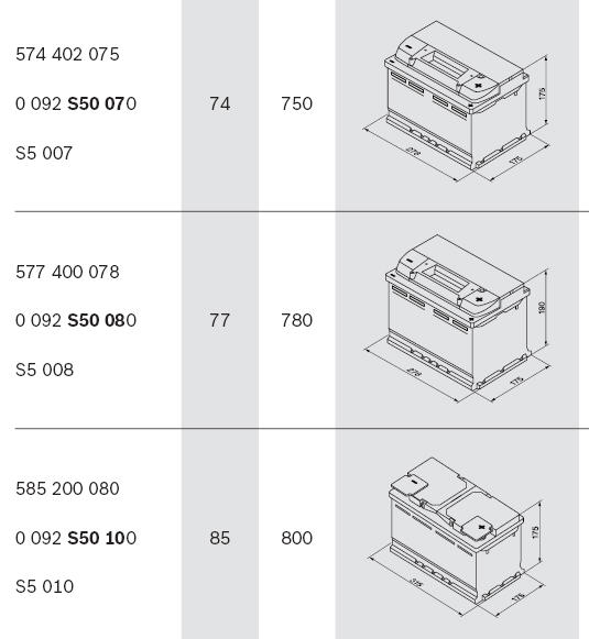

Hi Folks
Lots of confusion here... the battery Halfords recommends when I put in my registration is list HERE. This battery is only a 77 AH battery which is less powerful than you've been recommending? Here are the details:
  • Startup Power: 780 Amps
  • AH Value: 77 AH
  • Bench Charge: 6 Amps
  • Weight: 18.65kg
  • Dimensions (LxDxH): 278x175x190mm
  • Guarantee: 5 Years
Does this sound like the battery for me? I've looked for the "010", Richard but cannot get the Halfords site to dish it up without entering my registration number, at which point it reverts to the above battery? Whatcha think?
Chris
The Bosch silver that Richard refers to was available at Costco. That is what is fitted to my 996. It isn't specifically listed for a 911 at Costco (I think it is for a transit van !) but the physical dimension is perfect and the Ah is fine for a 996
I would have thought that a 77Ah is fine as well.
What were Halfords quoting ? I think My Bosch silver was around £90 at Costco. It was about a year ago i bought one.
I think Varta do a similar one which is readily available on the net. Just google it
Steve
In actual fact I have an S5 007 in mine, which is 74Ah and it's fine. I only used it because I had it "in stock" but it has coped perfectly well with cranking the car in the sub-zero temperatures last month. If I was going out to buy one, and I had a choice between the 008 (77Ah) and the 010 (85Ah) I would pay the extra and get the larger one.
