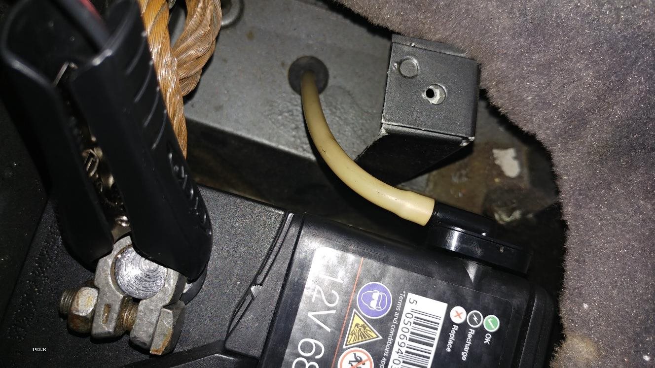

No from memory it is on a raised section near the earth lead, pipe length is maybe 15cm, I can probably grab a photo later,

This is from my cab which is 1991 but it is very similar to my 1990 - I think the connector to the battery is white and straighter on that from memory (excuse the waxoil making it look grubby in the background!)
Tony
I think mine (88) looks like the one Ruddy posted a pic of.
