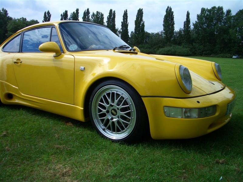

8.5J x 18 H2ET56 LM099 B14325 (10.6Kg) - BTW, NOT LM009
10J x 18 H2ET50 LM144 B14495 (11.0Kg)
I run them with spacers (26mm front and 32mm rear) to cater for the wider arches. For a narrow bodied car you may need some small shims (5mm) at the front but the rears should be OK as they are. I'd advise you NOT to use spacers (with the integral studs) since the LMs have very little accomodation behind the wheel for protruding studs. That's the reason I had to change my front spacers from 18mm to 26mm in order to prevent the standard studs protruding too much.
