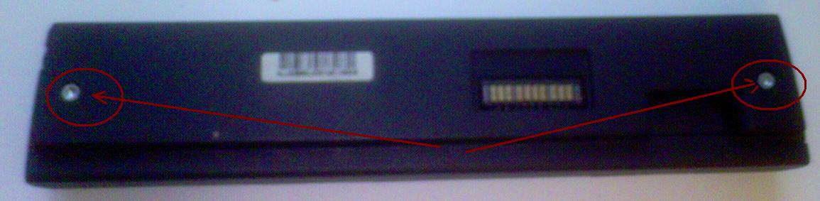

[FONT=verdana,geneva"] [FONT=verdana, geneva, arial, sans-serif"]The fascia-front arrived today. Wonderful - it'll be a perfect swap.[FONT=verdana,geneva"][FONT=verdana, geneva, arial, sans-serif"]
[FONT=verdana,geneva"] [FONT=verdana, geneva, arial, sans-serif"]My only trouble now is finding out what tool I need to undo the two screws on the back of the fascia that will release the fascia-front.
[FONT=verdana,geneva"] [FONT=verdana, geneva, arial, sans-serif"]I can't find an allen/[FONT=verdana,geneva"][FONT=verdana, geneva, arial, sans-serif"]hex[FONT=verdana,geneva"][FONT=verdana, geneva, arial, sans-serif"] key or philips screwdriver in my collection that fits the screws. These screws seem very 'strange' to my uneducated eye.[FONT=verdana,geneva"][FONT=verdana, geneva, arial, sans-serif"]
[FONT=verdana,geneva"] [FONT=verdana, geneva, arial, sans-serif"]Anyone got any ideas as to what tool I need to undo these screws?[FONT=verdana,geneva"][FONT=verdana, geneva, arial, sans-serif"]

[FONT=verdana,geneva"]Hi Mark & Shirish
Mark - the photo is absolute rubbish, I agree - sorry [:D]. I was hoping that someone psychic would recognise them.
Shirish: - thanks for being psychic [:D] - my new-found friend at Harmon/Becker USA (Robert Birchenough) says I need a torx driver t-8 bit. Robert is "to the point" to say the least, but he is very prompt and seemingly infallible. I don't suppose you know where I can get (borrow - I don't see me needing this tool on a regular basis) a torx driver t-8 bit?

[FONT=verdana,geneva"]Breaking news
Dave at DND Services - http://www.dndservices.co.uk - says, "
[FONT=verdana,geneva"][FONT=verdana,geneva"]Usually a small Torx bit, either T6 or T8".
