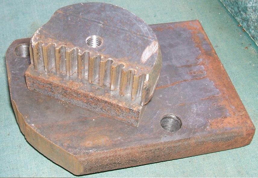

I believe the official Porsche flywheel lock can damage the bell housing... I made my own for the S2 out of 20mm thick Mild Steel plate, bolted in place of the starter motor, and then another rough circle of 20mm Mild steel cut to just fit inside the starter motor housing cut with teeth to match the flywheel - it needs to be tapered and spaced by 15mm from the starter motor flange if you want to do something similar, but it worked an absolute dream...

Any chance of a picture, as when I get back to work in the new year I'm going to make one myself. Just a few different designs whizzing round my head at the moment.

Hopefully I have attached a picture... sorry it is rather "functional" than handsome... handsome is as handsome does, and it was a doddle to use...
Hope this helps,
Tref.

Thanks for the pic. I've found some pics of the porsche tool so I'm thinking of something somwhere in between. No massive rush as I havn't got the belts yet. Food for thought tho' cheers!
