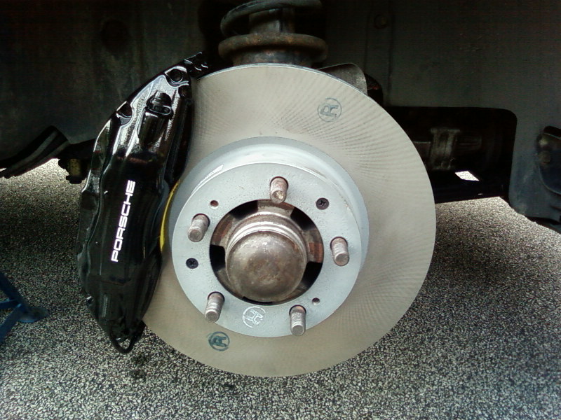

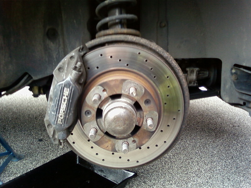

Just thought I'd post a couple of pics. Here's the before:-
Aye, those will do the trick. I have got 993TT Big Reds on mine and they do the trick really well. I didnt put them on the previous owner did [:)]
