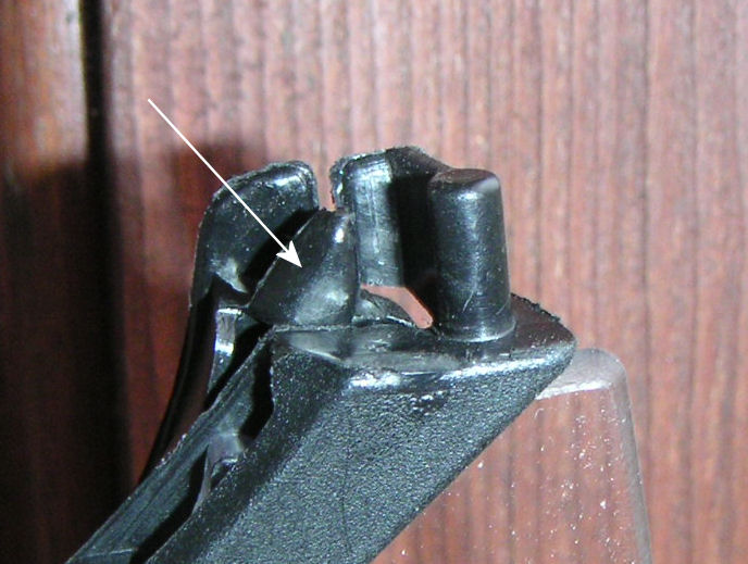

This is the part that usually breaks.
Look at the roll bar part. Make sure the piece of plastic where the yellow line is has not broken off.
Aha! Now i've put my glasses on, I can see the problem. The picture I've attached shows it as it should be. The troublesome side is lacking the triangular projection arrowed in my pic.
