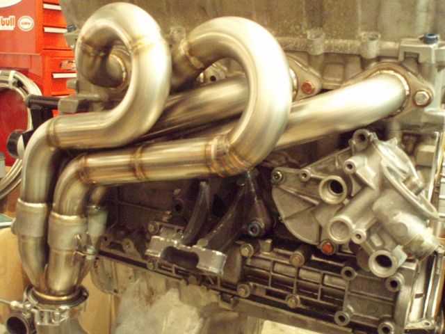

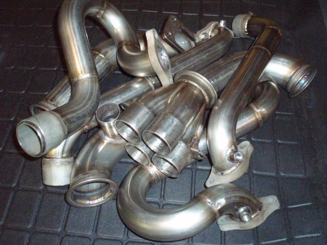

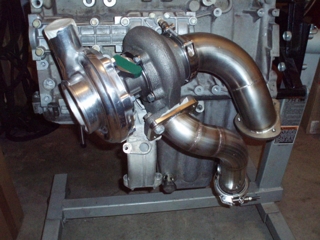

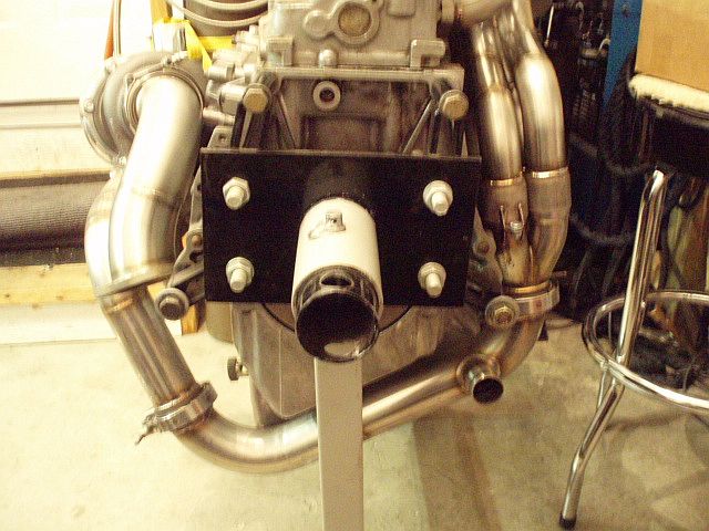

Actually Peter I was having another very special motor being built before the Economic Crash and had an exhaust made by Tim at SFR which is 3" out, 3.5" downpipe into a slip joined space for a removable Cat, then 4" ovalised pipe for clearance around the back axles, into 5" out. It's rather large. I could post a pic but here's a link to the Rennlist thread detailing this build which has a bunch of pics of the build.
http://forums.rennlist.com/rennforums/944-turbo-and-turbo-s-forum/475758-project-some-bits-and-pieces-that-are-due-to-get-together-soon.html

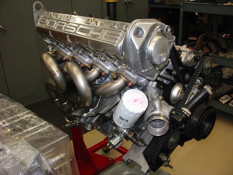

I'm sure Ti would be great if not a little expensive. The big exhaust and headers are 321 ss but the exhaust is definitely lighter than our stock one which is very restrictive and heavy with the 2 layers.
Yes Paul you're correct of course. The proof will be in the pudding. We took a lot of time building these so that they'd fit into an RHD car so fingers crossed that our efforts will be rewarded. The nice SFR headers for LHD cars are 1/8" bigger in diameter than stock and these are 1/4" larger so a decent increase in VE. Notice too the bungs that are right off the motor. These are the EGT x 4 sensors and this is the only way I believe that you'll get a true read rather than the one unit that people have relied upon in the past which has been located well down the pipes.
