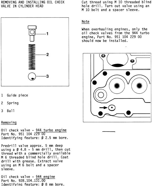

Dont quote me but I understand that there is a one way valve that prevents top end drain down and it can fail. Its an engine apart job to rectify I am told.
If it does it every time you start the car then its a drain down issue I suggest and the noise is the tappets `pumping up` so when primed they go quiet. It doesnt mean the bottom end is starved of oil though.
I may be wrong so wait for further comment from others.

I do have a comprehensive workshop manual covering all models of 944 if anyone wants a copy, its on cd rom just let me know.
Look out for the one way or drain down prevention valve/thingy in the manual and let us know if there is such a thing please, thanks.
You mean this? See page 17 - 16.
There ya go, I thought I was right [;)]
I assume this is in the head and is a one way valve in the oilway that supplies the head/cam or is in a return from the head? The sketch seems to show the top of the head so if the ball bearing is at the bottom it must be in the supply??
I would imagine it sticks open thereby allowing the oil to drain back down so the head/cam loses its prime and hence has to `pump up` ?? Its probably not a big deal but wear will occur quicker to the valve train I suppose and as the prime is lost it probably takes slightly longer for the whole system to achieve pressure when cold (I`m talking seconds here)
Anyone familiar with it? Care to comment? Can it be changed with the head in situ? Also there are two references to extraction, M6 and M10 ????? Whats all that about or is the M10 the later one to install??
