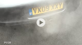

My 2009 987.2 3.4 Boxster S has suddenly started billowing lots of white smoke on starting up from cold, and there is a pool of what looks like water on the ground below the exhaust pipes. There is sufficient smoke to obscure the back of the car and it goes on producing smoke for some time.
I've had the car 2 years now and it's not done this before other than maybe a very small puff. The car hasn't been used very differently recently and this problem suddenly appeared one morning and had continued since. To be fair I haven't driven it much since it happened, I wanted to find owhat the problem was first.
The OPC has been unable to find a fault, other than the cloud of white smoke coming when they've started it themselves. Coolant level has not gone done and the diagnostics are normal. Fortunatelythe car is under warranty
Any ideas - the OPC say the next stage is to do a compression test but the warranty won't cover this if no fault is found.
Fortunately the car is under warranty
