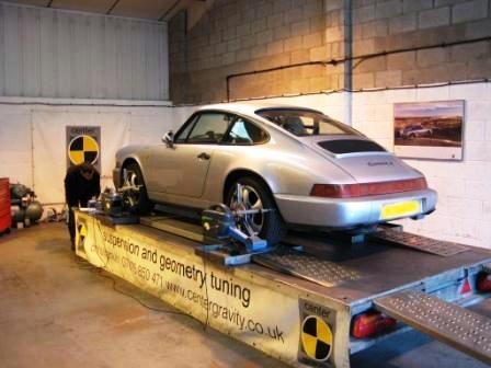

Here's a pic' with the 964 undergoing the geometry set-up

Thanks Steve. The shocks that were replaced were the originals, hence 15 years old, they were knackered! totally. Also the bushes in the lower wishbones had seen better days, although they are a b*tch to remove. Hard to tell with the springs, the likelyhood is they had lost 30% or more of their stiffness! So without doubt it was a job well needed.
The car now feels taught and planted. The steering is really positive and responsive. Without stealing Chris's words.... 'the car feels like a new 964!' Any adjustment required in the future will be a dream as everything that had been removed or replaced has been meticulously cleaned and copper slipped, then the completed job wax-oiled...... beautiful.
The test drive was great and in the dark! as the time that day had marched on!. Chris drove first and as with his work, explained in detail and at every stage along the route exactly what and how he expected the car to handle, on differing road surfaces, differning road cambers, cornering, twisting, roundabouts, under breaking and so on ........ You guessed it, it passed. Then my go, great, would have been good to have done the circuit a few times, however time was clocking on and besides i had a 100+ mile drive back home., fantastic!!
