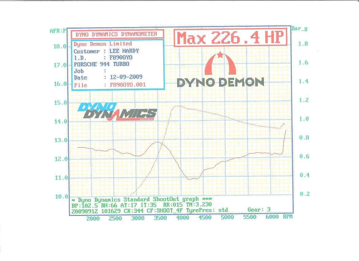

I have included a recent Dyno graph of my Boost and AFR.
Runs very rich to start and then goes lean on boost.
Someone suggested my air fuel meter may be not working as it should?
Any other thoughts
the graph doesn't suggest you have a boost leak. What are the mods you have made to the car? - FPR? chips?

From what you said, this is a problem on WOT, so I don't think the AFM plays a big part.
Thinking about it, you may be losing a bit of boost (although nothing major) I haven't studied many charts with an MBC and DPW, but maybe the boost shouldn't drop off? - mine will hold 15psi all the way now. It used to look more like that when I had the LBE fitted. But a boost leak would make it go richer at the top end, so it's not the primary cause here.

That Dyno sheet is not far off where you want to be, but if it's suddenly got a lot worse then I would suspect maybe your FPR is suddenly delivering too much fuel. How old and what are the state of your plugs? If they are not providing a healthy spark it could be leaving some fuel unburnt before the exhaust valves open
John at Vitesse told me that ideally you want to be around 14:1 when cruising around off boost, 12.5:1 up until the boost hits 7psi (0.5bar), and anything higher than 7psi should be 11.5:1
Your graph from last month is slightly lean until 3500rpm, then ever so slightly rich from 4000-4500rpm and then it goes lean again climbing to over 12:1 by the redline. It's always within 0.5 or 1 of where it should be so it's not dangerous and probably about as close as an off the shelf map can be.

With that setup you should be getting around 300hp? I have a non S model with the lvl 2 kit producing 275hp. Unless the hp figure on the afr/boost graph is not the actual one.
Could be wheel hp not flywheel - suggesting around 270 flywheel?
Dynos vary in their results, so I wouldn't read too much into that. My 250 turbo made 285 HP on the Weltmeister dyno (same one yours was measured on I think) at 11psi with an LBE - would expect a bit more holding 15psi now with MBC and MAF.

Yes you are right it should be making 300bhp at the flywheel. The figure on the chart was wheel horse power.
It made 270bhp on the day at the flywheel, still 20 or 30 down on where it should be which is why I am trying to diagnose a few problems now.
