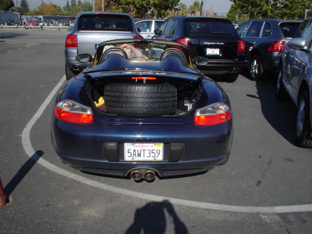

rear wheel in front boot..
and a new tyre on the passenger seat..

ORIGINAL: Tool Pants
Yankee ingenuity....
On the 987 you'd get a "Bong, bong, bong, bong, bong, bong....." sound and "Rear lid not closed!!" warning from the on-board nanny.
