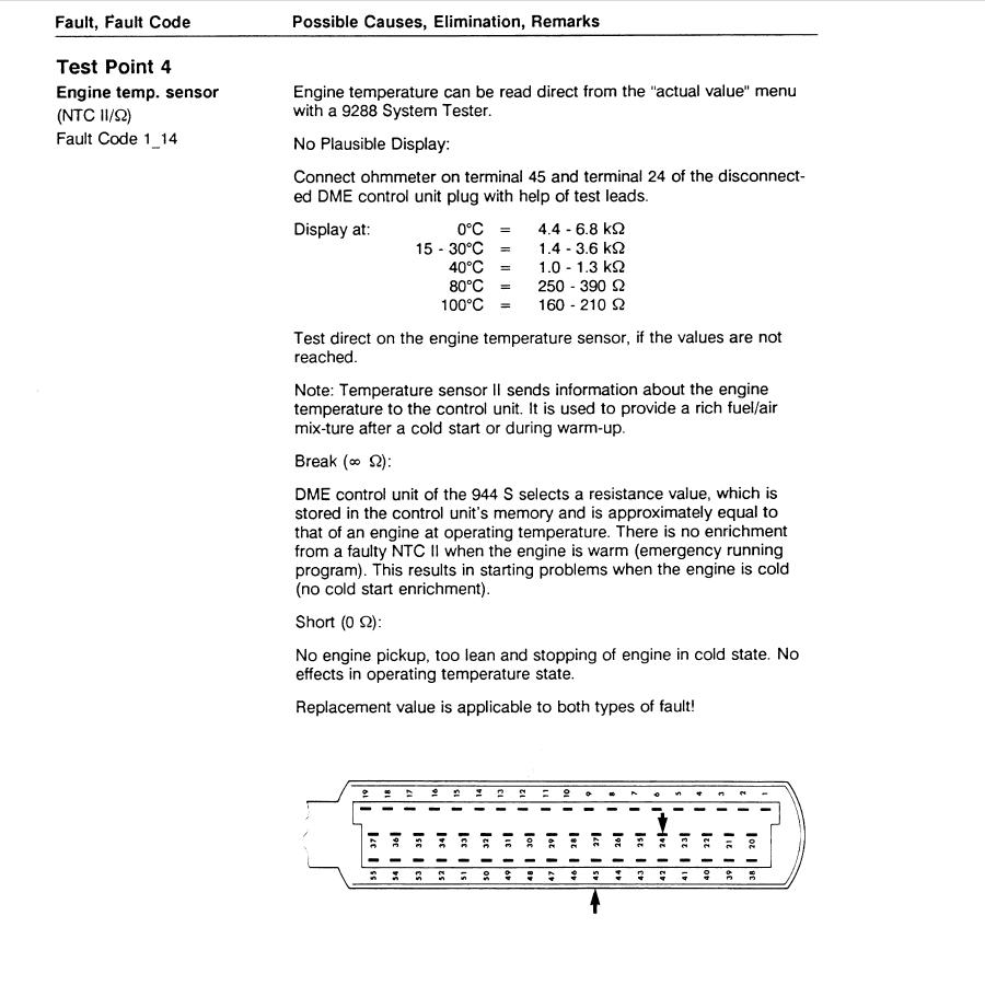

Is there any way to test the sensor or is it just a case of replacing it and hoping for the best??
cheers
Here is the page from the workshop manual that covers the sensor. It gives the resistance values that the sensor should read at various temperatures. The manuals are normally available for download at www.cannell.co.uk
