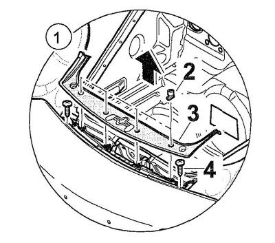

It's under here:

Apparently (and I can't say that I have looked myself) the switch is in the area of the bonnet catch, under the panel.
