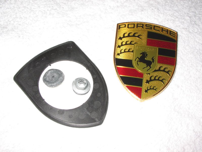

There are two self-tapping nuts which cut a thread on the pins on the back of the badge. You can undo them with a 10mm socket.
Top tip: Dunk the gasket in a cup of boiling water for a couple of minutes before you fit it. This makes it pliable and stretchy. Also, be careful not to do the nuts up too tight, as they strip the thread very easily.
Also be careful not to lose the nut out of the socket and inside the hollow strengthening members on the bonnet lid. They rattle about and drive you nuts trying to retrieve them.
You can guess how I know[:mad:]

The "tapping nuts" are the pressed steel nuts as shown in the photo I posted above. They are formed to a hexagon (to fit a socket) and the centre hole is shaped to cut a thread on the pins which protrude from the bottom of the badge itself. When you buy them new (they usually come in the kit) they have a dollop of mastic on the bottom to create a seal (also shown in the photo). When I get my car back on Sunday, I'll check the socket size - unless someone else beats me to it. (Anyone?)
