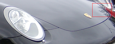

I have a 997 S in Atlas Grey which I particularly like, except for reflections off the bonnet. After owning for a few months I have noticed that there are marks in the metal work which show through the paintwork in the corners (towards the front) just above the bumper.
When viewed from the front, on the LHS there is a shallow depression which runs around the corner and is about an inch away from the edge. On the RHS there is a similar depression however this has the appearance of more than a manufacturing 'fold' in the aluminium and there is a definite hollow over an area obout two inches across. Since both depressions are dissimilar I associate this with the panels getting damaged especially on the RHS.
Last night I watched top gear "" Jeremy Clarkson discussing the 997 Turbo where he was impressed by the 40-60 times (just a second). As a 997 owner I could pick up on the exact same issue in their car. As the car swept around the bends the reflections off the RHS corner (when viewed from the front) were exactly as mine.

I think what you are describing are tooling marks from the press tool dies - these will have been deemed acceptable quality by the factory - as press tools age these will wear and the marks get worse, until such time as the dies are dressed and rechromed. They might also be areas where the panel has been reworked prior to painting, as a result of imperfections. Annoying if you are fussy about the car, even worse if you use high gloss finishes like Zymol which highlight the imperfections further.
In comparison look at a dark painted 986/996 series door skin and you'll never think about your bonnet in the same way agin !!

At the OPC this morning and had a chance to look over some other 997 bonnets especially the front corners. After looking over the closest ones to where I parked I concluded that the effect I see is present in almost all cases.
ORIGINAL: yossarian
Is it photographable? Sounds like it might be a rather subtle imperfection to pick up easily on an ordinary photograph however.
I don't have a photograph of my car however it is easy to find examples on the www - here's one I 'cropped' earlier...
(The 'tennis ball' effect on the RHS - when viewed from front isn't on the LHS).
Last Saturday I visited my OPC (Bournemouth) and had a chat about the bonnet with their valet chap. The conversation went from 'we can get this fixed' to 'they are all like it'.
As well as looking at my own bonnet, I had the opportunity to observe the same effect on new cars - a new 997 Cabriolet also in Atlas Grey in the showroom, and a line of 997's amongst the vehicles for sale outside. We couldn't find a single 997 which didn't have the 'tennis ball' effect on the RHS. All the examples also had a visible edge around the LHS corner but the effect is less pronounced.
With cars in Arctic Silver the affected area is less obvious, but on a darker colour like mine e.g. Atlas Grey the contours of the bonnet are more easily seen.
